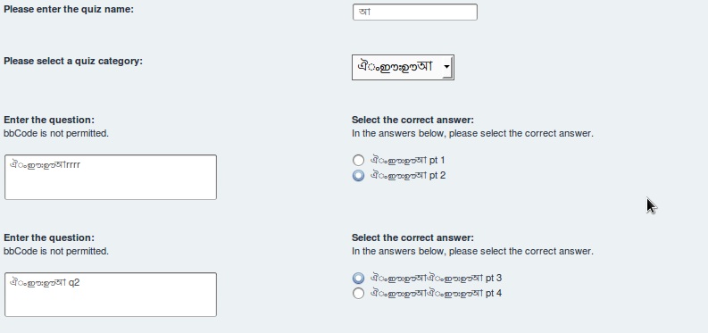

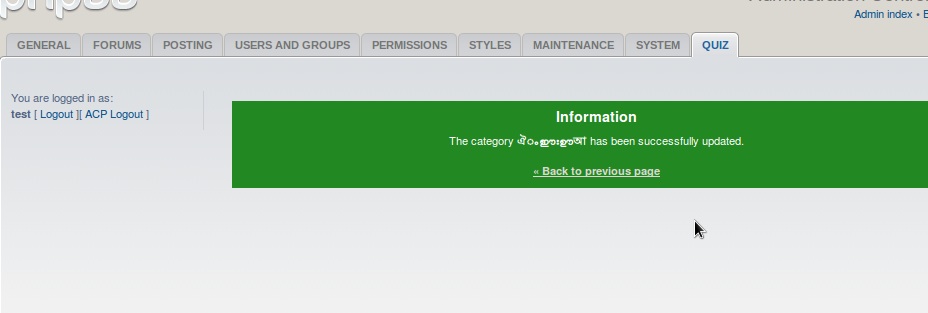

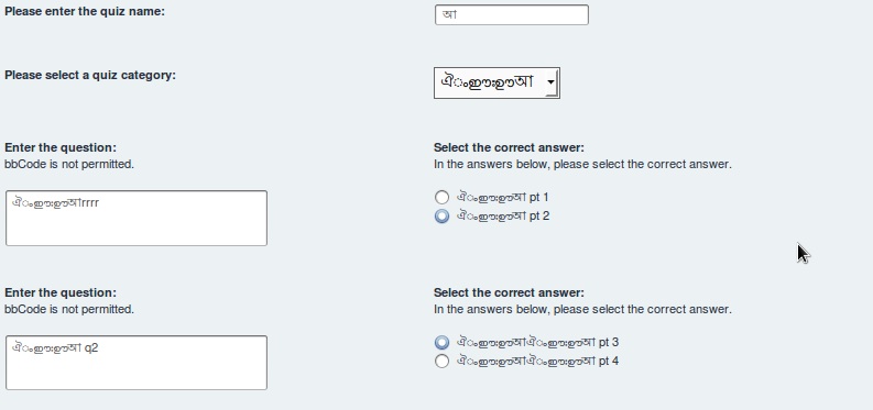

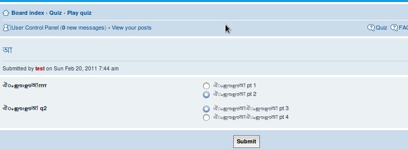

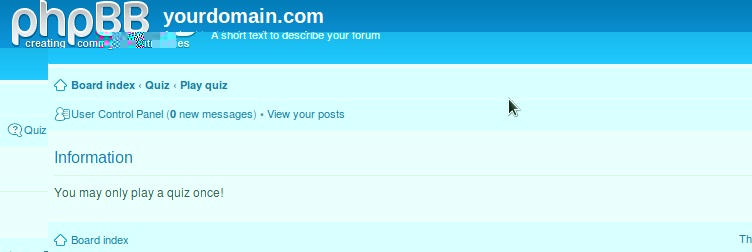

Edit 2: screenshots of foreign characters working + the quiz play once setting below. I also found a bug whereby if the "show answers" config setting is disabled, then no quiz statistics are stored - that's fixed now :)
Quiz play once config setting (in use)
Foreign characters when submitting a quiz
Foreign characters when playing a quiz
Foreign characters in categories
