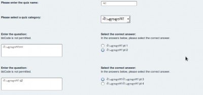

Quiz mod can't support Multil language.
if i use english name is work!
else
Posts: 14413
Ahhh, the foreign characters always get me :(
The fix mainly consists of adding a "true" parameter at the end of the request_var function.

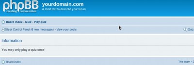

Edit 2: screenshots of foreign characters working + the quiz play once setting below. I also found a bug whereby if the "show answers" config setting is disabled, then no quiz statistics are stored - that's fixed now :)
Quiz play once config setting (in use)
Foreign characters when submitting a quiz
Foreign characters when playing a quiz
Foreign characters in categories
